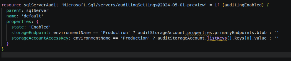

The following CLI code will not deploy. AI says it's out of date for Azure and everything I have tried to fix it is not working. I can't complete this Bicep lesson if it won't deploy. This comes from - https://learn.microsoft.com/en-us/training/modules/build-flexible-bicep-files-conditions-loops/ - Here is the code that Learn says is correct :

Here are the 2 error codes I'm getting which won't allow it to deploy:
  • The value of type "Microsoft.Storage/storageAccounts | null" may be null at the start of the deployment, which would cause this access expression (and the overall deployment with it) to fail.
  • A resource of type "Microsoft.Storage/storageAccounts | null" may or may not exist when this function is called, which could cause the deployment to fail.
I have included a screen shot of where VS Code says the errors lie. AI gave me several 'fixes' which just lead to more and different error codes that still wouldn't deploy. Screenshot from 2026-05-20 12-54-26.png - Here's what I need help with:

  1. Divyesh Govaerdhanan 11,065 Reputation points MVP Volunteer Moderator
    2026-05-21T16:29:31.7833333+00:00
    Hi Daniel Cecchini,
    Welcome to Microsoft Q&A,
    When you declare a resource conditionally with = if (...), newer versions of the Bicep compiler treat that resource as a type Microsoft.Storage/storageAccounts | null because it may or may not exist at deployment time. When you then access .properties.primaryEndpoints.blob or call .listKeys() on it, the compiler raises diagnostic BCP318 because it cannot guarantee the resource exists at that point. The training module was written before the Bicep compiler introduced stricter null safety checks, which is why it worked then, but now flags.
    Add the null-forgiving operator (!) directly after auditStorageAccount in these two lines inside your sqlServerAudit resource:
    storageEndpoint: environmentName == 'Production' ? auditStorageAccount!.properties.primaryEndpoints.blob : ''
    storageAccountAccessKey: environmentName == 'Production' ? auditStorageAccount!.listKeys().keys[0].value : ''
    The ! tells the Bicep compiler "I know this resource is not null here, trust the condition." Since both lines are already guarded by environmentName == 'Production' which matches the same condition the storage account deploys under, this is safe to use.
