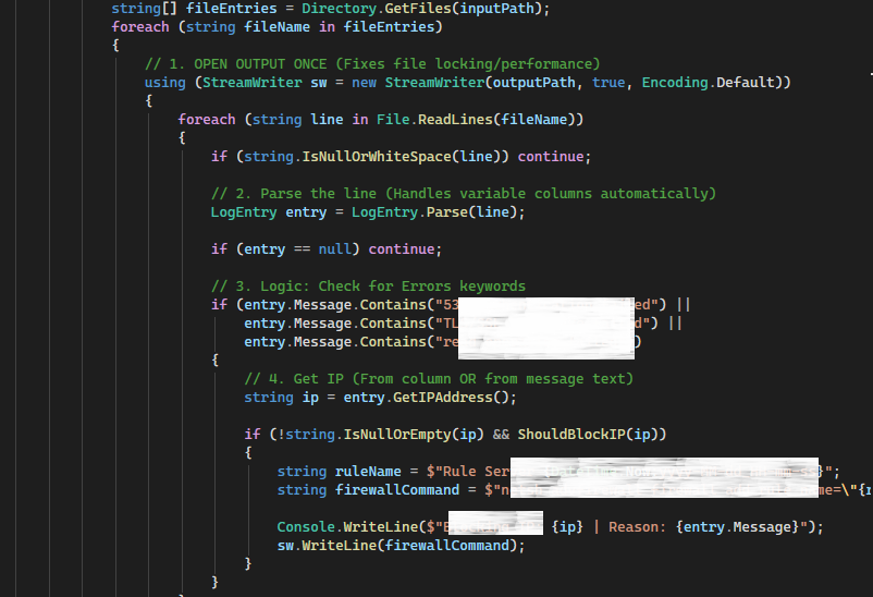

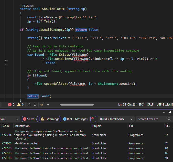

Enhance the way of linear search
Jonathan 170 Reputation points
2026-05-31T04:50:50.82+00:00

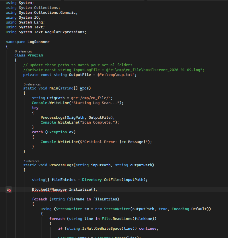

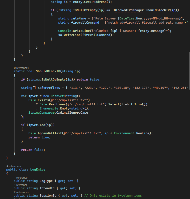

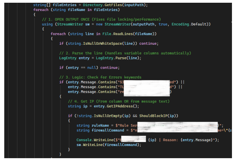

To C# linear search below
any advice to apply the following way on the above?

Hi @Jonathan ,
I apologize for the delayed response. I have received your sharing regarding the issue.
The core issue is that your current code reads the entire file on every single IP check. This means if 1,000 visitors arrive at the same time, your program opens and reads the file 1,000 times.

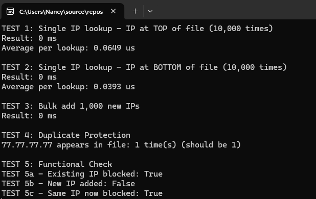

I have already tested this on my side and checked the performance.
You can refer to my example code below:

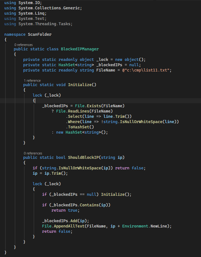

BlockIPManager.cs:
public static class BlockedIPManager
    private static readonly object _lock = new object();
    private static HashSet<string> _blockedIPs = null;
    private static readonly string FileName = @"c:\cmp\list11.txt";
    public static void Initialize()
        lock (_lock)
            _blockedIPs = File.Exists(FileName)
                ? File.ReadLines(FileName)
                      .Select(line => line.Trim())
                      .Where(line => !string.IsNullOrWhiteSpace(line))
                      .ToHashSet()
                : new HashSet<string>();
    public static bool ShouldBlockIP(string ip)
        if (string.IsNullOrWhiteSpace(ip)) return false;
        ip = ip.Trim();
        lock (_lock)
            if (_blockedIPs == null) Initialize();
            if (_blockedIPs.Contains(ip))
                return true;
            _blockedIPs.Add(ip);
            File.AppendAllText(FileName, ip + Environment.NewLine);
            return false;

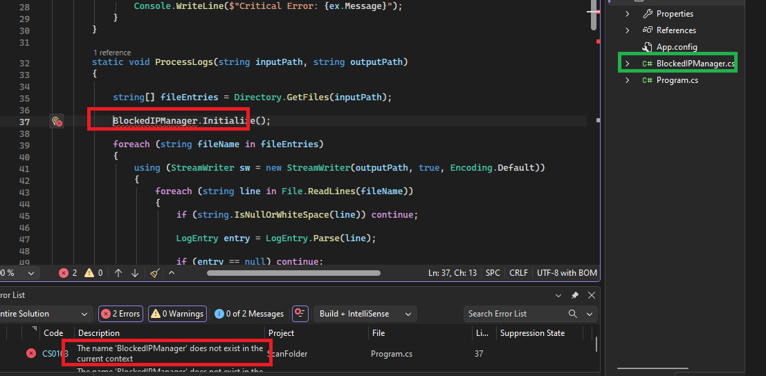

Program.cs
using System.Diagnostics;
BlockedIPManager.Initialize();

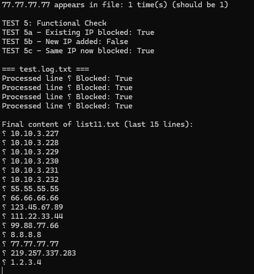

Console.WriteLine("TEST 1: Single IP lookup — IP at TOP of file (10,000 times)");
sw.Restart();
for (int i = 0; i < 10000; i++)
    BlockedIPManager.ShouldBlockIP("113.45.67.89");
sw.Stop();
Console.WriteLine("Result: " + sw.ElapsedMilliseconds + " ms");
Console.WriteLine("Average per lookup: " + (sw.Elapsed.TotalMicroseconds / 10000).ToString("F4") + " us");
Console.WriteLine("");
Console.WriteLine("TEST 2: Single IP lookup — IP at BOTTOM of file (10,000 times)");
sw.Restart();
    BlockedIPManager.ShouldBlockIP("192.168.1.255");
sw.Stop();
Console.WriteLine("TEST 3: Bulk add 1,000 new IPs");
var bulkIPs = Enumerable.Range(1, 1000)
    .Select(i => $"10.10.{i / 256}.{i % 256}")
    .ToArray();
sw.Restart();
BlockedIPManager.AddBlockIPs(bulkIPs);
sw.Stop();
Console.WriteLine("TEST 4: Duplicate Protection");
string testIP = "77.77.77.77";
BlockedIPManager.ShouldBlockIP(testIP);
var count = File.ReadAllLines(@"c:\cmp\list11.txt")
    .Count(l => l.Trim() == testIP);
Console.WriteLine(testIP + " appears in file: " + count + " time(s) (should be 1)");
Console.WriteLine("TEST 5: Functional Check");
bool result1 = BlockedIPManager.ShouldBlockIP("123.45.67.89");
Console.WriteLine("TEST 5a - Existing IP blocked: " + result1);
bool result2 = BlockedIPManager.ShouldBlockIP("8.8.8.8");
Console.WriteLine("TEST 5b - New IP added: " + !result2);
bool result3 = BlockedIPManager.ShouldBlockIP("8.8.8.8");
Console.WriteLine("TEST 5c - Same IP now blocked: " + result3);
Console.ReadLine();

    Instead of applying SearchValues + Parallel.ForEach to your existing List, I would suggest a simpler and more effective approach - replace List<string> with HashSet<string>.
    You can refer to my example code:
    var ipSet = new HashSet<string>(
        File.Exists(@"c:/cmp/list11.txt")
            ? File.ReadLines(@"c:/cmp/list11.txt").Select(l => l.Trim())
            : Enumerable.Empty<string>(),
        StringComparer.OrdinalIgnoreCase
    public static bool AddIfNotExists(string ip, HashSet<string> ipSet)
        ip = ip.Trim();
        if (ipSet.Add(ip))
            File.AppendAllText(@"c:/cmp/list11.txt", ip + Environment.NewLine);
            return true;
        return false;
    I hope this addresses your question. If this response was helpful, please consider following the guidance to provide feedback.

    2026-05-31T04:51:05.11+00:00
    List<T>.FindIndex performs a linear search (O(n)) on every lookup. For frequent lookups or large collections, replace the list-based search with a data structure that provides O(1) lookup.
    A typical enhancement is to use HashSet<string> or Dictionary<string, TValue> instead of repeatedly calling FindIndex on List<string>:
    // Build a HashSet once from the existing list
    var ipSet = new HashSet<string>(list0);  // case-sensitive; use custom comparer if needed
    // When checking/adding a new IP
    if (!ipSet.Contains(ip))
        ipSet.Add(ip);
    // When persisting back to file, enumerate the set
    File.Delete(@"c:/cmp/list11.txt");
    using (var sw = new StreamWriter(@"c:/cmp/list11.txt", append: false))
        foreach (var item in ipSet)
            sw.WriteLine(item.Trim());
    Key improvements compared to the original linear search with FindIndex:
    1. HashSet<string>.Contains is O(1) on average, instead of O(n) for List<T>.FindIndex.
    2. The output file is opened once and written in a single pass, instead of opening a new StreamWriter inside the loop.
    3. The collection (ipSet) naturally enforces uniqueness, so duplicates are avoided without extra checks.
