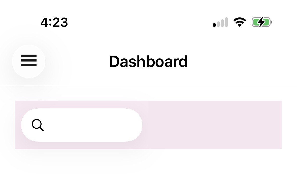

Partial Main page snapshot when running app on an iPhone 15, iOS 26.5:
IMG_5536
Notice that the background of the search bar on the left is not the same color as on the right, whereas they are both specified as "Red".
Also, if you sample the colors you will see that there is a light gray shadow around the search bar (except on the right) that gradually filters into the white background color.
What is the proper way to eliminate the "darkening" of the background color on the search bar?
If the shadow cannot be eliminated, that is OK. I'm mainly concerned about the search bar background color.

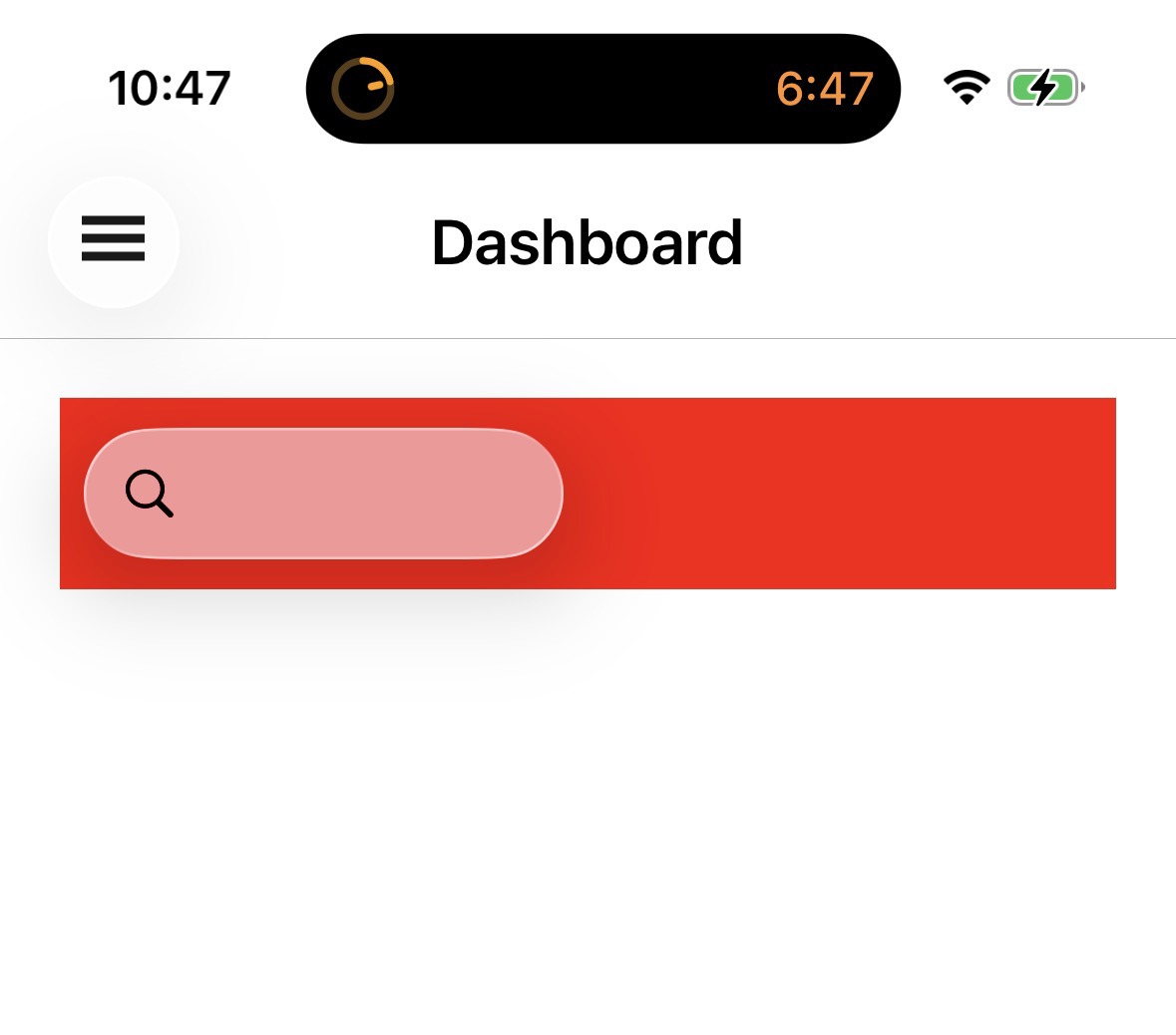

    2026-06-02T00:16:43.0933333+00:00
    In .NET MAUI 10 on iOS, the visual appearance of SearchBar is controlled by the native UISearchBar, including its style and background behavior. The UISearchBarStyle.Minimal style specifically removes the bar background and renders the search field itself as a translucent element, which causes:
    • The search field color to be composited with the page background, making the color appear lighter/darker than the solid Red used on the surrounding layout.
    • A subtle shadow/blur around the control as part of the native iOS rendering.
    Setting only handler.PlatformView.BackgroundColor and BarTintColor while using UISearchBarStyle.Minimal does not override this compositing behavior, so the search field will not match the solid Red of the BoxView, and the shadow remains.
    To get a solid background color that matches the surrounding layout and avoid the translucent effect, configure the iOS-specific SearchBarStyle to a style that has a background instead of Minimal, for example:
    <ContentPage
        xmlns:ios="clr-namespace:Microsoft.Maui.Controls.PlatformConfiguration.iOSSpecific;assembly=Microsoft.Maui.Controls">
        <Grid>
            <SearchBar
                ios:SearchBar.SearchBarStyle="Prominent"
                BackgroundColor="Red" />
        </Grid>
    </ContentPage>
    or in C# using the fluent API:
    using Microsoft.Maui.Controls.PlatformConfiguration;
    using Microsoft.Maui.Controls.PlatformConfiguration.iOSSpecific;
    searchBar.On<iOS>().SetSearchBarStyle(UISearchBarStyle.Prominent);
    searchBar.BackgroundColor = Colors.Red;
    Prominent and Default styles keep the bar background and avoid the strong translucency of Minimal, so the BackgroundColor applied to the SearchBar will be much closer to the solid Red of the surrounding view, and the perceived “darkening” caused by the translucent overlay is removed.
    The subtle shadow is part of the native control’s visual design and is not removed by MAUI APIs; however, switching away from Minimal eliminates the gray halo effect that comes from the translucent blending with the page background.

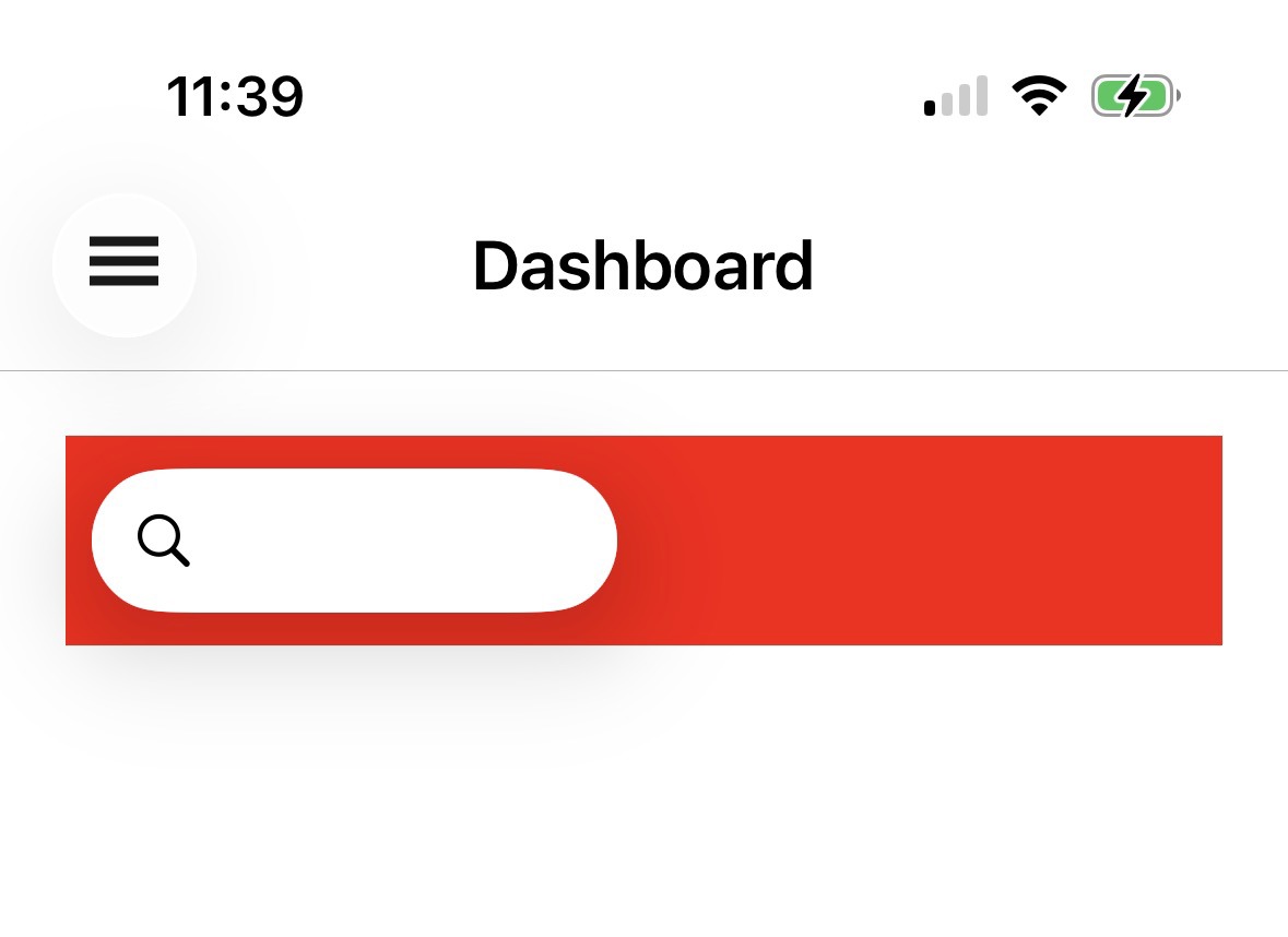

  2. Nancy Vo (WICLOUD CORPORATION) 5,700 Reputation points Microsoft External Staff Moderator
    2026-06-09T06:28:10.58+00:00
    Hi @Kurt K ,
    Thank you for your patience.
    Due to Apple’s new iOS 26 Liquid Glass design system, which automatically overrides your SearchBar styling, I recommend opting out of Liquid Glass:
    Platform/iOS/Info.plist:
    <key>UIDesignRequiresCompatibility</key>
    <true/>
    You can refer to the following code example:
    MauiProgram.cs:
    using Microsoft.Extensions.Logging;
    namespace SearchBarProject;
    public static class MauiProgram
        public static MauiApp CreateMauiApp()
            var builder = MauiApp.CreateBuilder();
            builder
                .UseMauiApp<App>();
            Microsoft.Maui.Handlers.SearchBarHandler.Mapper.AppendToMapping("CustomSearchBar", (handler, view) =>
    #if IOS
                var searchBar = handler.PlatformView;
                searchBar.SearchBarStyle = UIKit.UISearchBarStyle.Minimal;
                searchBar.BackgroundImage = new UIKit.UIImage();
                var textField = searchBar.SearchTextField;
                textField.BackgroundColor = UIKit.UIColor.White;
    #endif
            return builder.Build();
    MainPage.xaml:
    <?xml version="1.0" encoding="utf-8" ?>
    <ContentPage xmlns="http://schemas.microsoft.com/dotnet/2021/maui"
                 xmlns:x="http://schemas.microsoft.com/winfx/2009/xaml"
                 x:Class="SearchBarProject.MainPage">
    <ScrollView>
                        <Grid Padding="20" >
                            <Grid.RowDefinitions>
                                <RowDefinition Height="Auto" />
                            </Grid.RowDefinitions>
                            <Grid Grid.Row="0" ColumnDefinitions="*,*" BackgroundColor="Red">
                                <SearchBar Grid.Column="0" BackgroundColor="Transparent"/>
                                <BoxView Grid.Column="1" BackgroundColor="Transparent"/>
                            </Grid>
                        </Grid>
                    </ScrollView>
    </ContentPage>

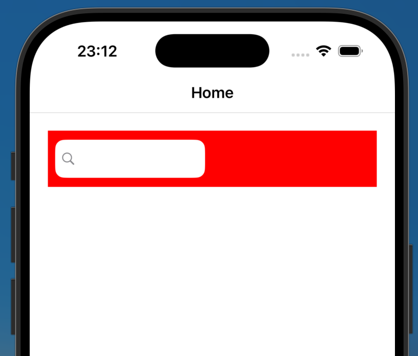

    I tested this using Digital Color Meter to verify the color values. Both the left and right sections now display RGB (255, 0, 0).
    Note: You can change the color of the SearchBar text field by modifying this line in MauiProgram.cs:
    Please test again and let me know the result.
