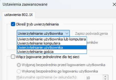

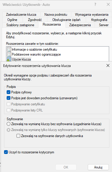

However, when I switch the profile to user authentication, I receive the following error:
Reason: 0x50005
Reason Text: Network authentication failed due to a problem with the user account
Error Code: 0x40420110

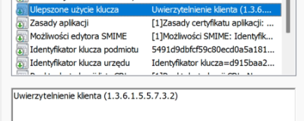

The Windows 11 client has the Root CA installed, so the trust requirement should be satisfied. The certificate is valid. The only potential issue I can think of is CRL validation, since the client does not yet have network access. However, I verified that the CRL is present in the local cache, so in theory this requirement should also be met.
Do you have any suggestions on what else could be causing this issue, what additional checks I should perform, or where I might have made a mistake?

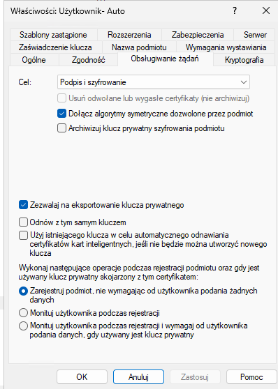

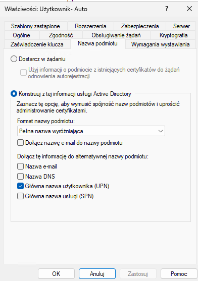

    1. Modify the Certificate Template on the CA Server (Main Cause)
    Windows 11 requires the User certificate to contain account identification information.
    • On the CA Server, open the Certificate Templates Console -> Right-click on the User template -> Properties -> Subject Name tab.
    • Check the box "Include User Principal Name (UPN) in subject alternative name".
    • Delete the old certificate on the client machine and auto-enroll a new certificate.

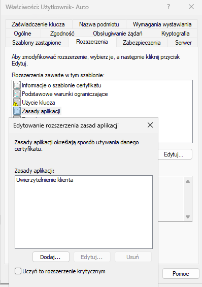

    • In the Details tab -> Enhanced Key Usage, the line Client Authentication (1.3.6.1.5.5.7.3.2) must be present.

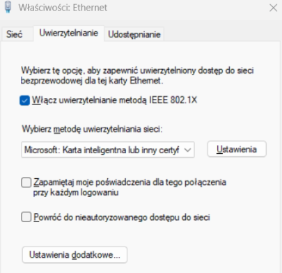

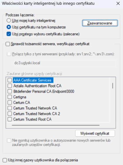

    1. Verify the 802.1X Profile Configuration on the Client
    • Go to Network Properties (Wired/Wireless Properties) -> Security tab -> Select Smart Card or other certificate -> Click Settings -> Click Advanced.
    • Temporarily uncheck advanced filters such as Certificate Issuers or EKU to prevent Windows from automatically filtering out the user's certificate.
