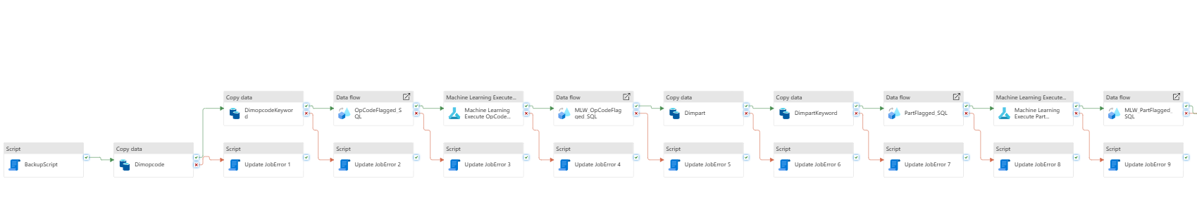

I have an Azure Data Factory pipeline that orchestrates a multi-stage classification workflow. Right now every activity is chained one after another with success dependencies, so the whole pipeline runs strictly sequentially and takes a long time end-to-end. I'd like to run the parts that are independent of each other in parallel to cut the total runtime.
Current setup
Everything lives in one ADF pipeline and is fully chained left-to-right. Simplified:
Script (backup)
→ [Segment A: OpCode]   Copy data → Data Flow (flag) → Azure ML pipeline (classify) → Data Flow (write back)
→ [Segment B: Part]      Copy data → Data Flow (flag) → Azure ML pipeline (classify) → Data Flow (write back)
→ [Segment C: Customer]  Copy data → Data Flow (flag) → Azure ML pipeline (classify) → Data Flow (write back)
  • Each Azure ML pipeline is invoked from an Execute ML Pipeline activity.
  • The three segments (OpCode, Part, Customer) are functionally separate classification jobs.
  • The only ordering that genuinely matters is within a segment (load → flag → classify → write back). That internal order must stay sequential.User's image

    1. Yes. A single Azure Data Factory pipeline can run multiple activities in parallel, including multiple Execute Azure ML Pipeline activities, as long as there is no dependency configured between them. When multiple activities in a pipeline have no dependency on each other, they can run in parallel.
    2. The correct pattern in ADF is to fan out after the backup step:
      • Keep each segment’s internal sequence (Copy → Data Flow → Execute ML Pipeline → Data Flow) chained with success dependencies.
      • Connect the backup activity’s success output to the first activity of each of the three segments.
      • Do not chain Segment A → Segment B → Segment C. With no cross‑segment dependencies, ADF will schedule the three branches in parallel and the pipeline run will complete only after all branches finish.
      This aligns with the documented behavior that when multiple activities exist in a pipeline and subsequent activities are not dependent on previous activities, they may run in parallel.
