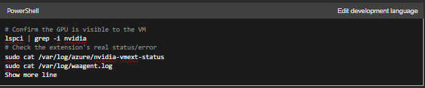

    Diagnostics to confirm root cause
    Confirm the GPU is visible to the VM
    A line like nvidia: module verification failed: signature and/or required key missing confirms the Secure Boot cause.
