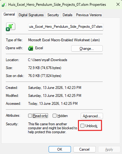

  1. myall_blues 0 Reputation points
    2026-06-13T04:19:02.7166667+00:00
    Another possibility, if you downloaded the file from somewhere, is that it has been blocked.
    In file explorer, right click on the file and select properties.
    On the general tab, at the bottom, check the 'Unblock' checkbox next to the security heading.
    Regards
    Murray
