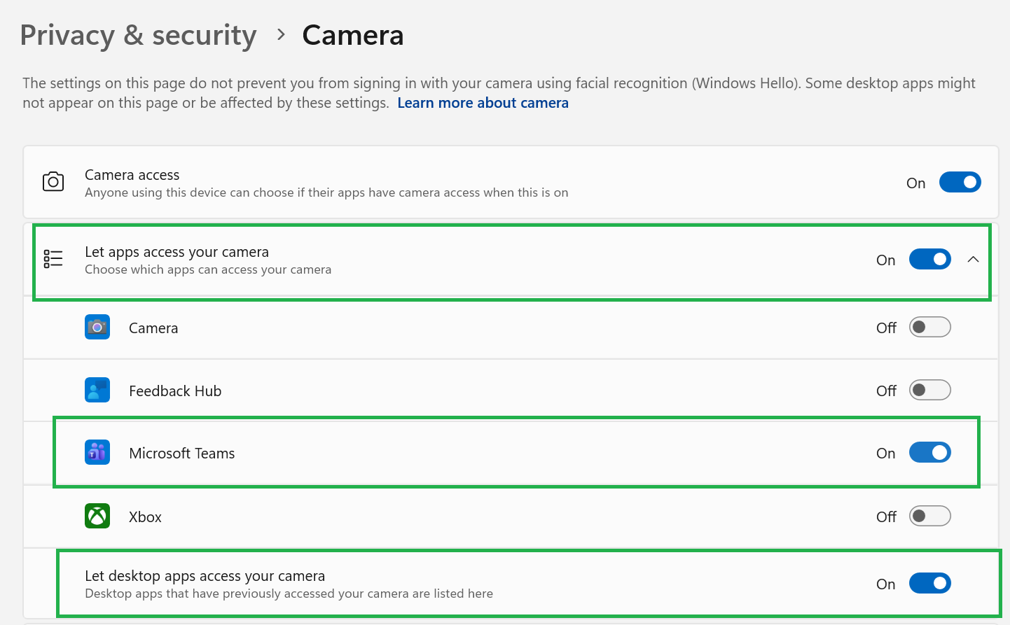

    2. Verify Windows camera privacy settings
      • Select Start > Settings > Privacy & security > Camera.
      • Under Allow access to the camera on this device, select Change and turn Camera access for this device On.
      • Make sure Allow apps to access your camera (or Let apps access your camera) is On.
      • Under Let apps access your camera, ensure Microsoft Teams (work or school) is turned On. If it is already on, turn it Off and then On again.
      • If using the desktop Teams app (not from Microsoft Store), make sure Let desktop apps access your camera is turned On.

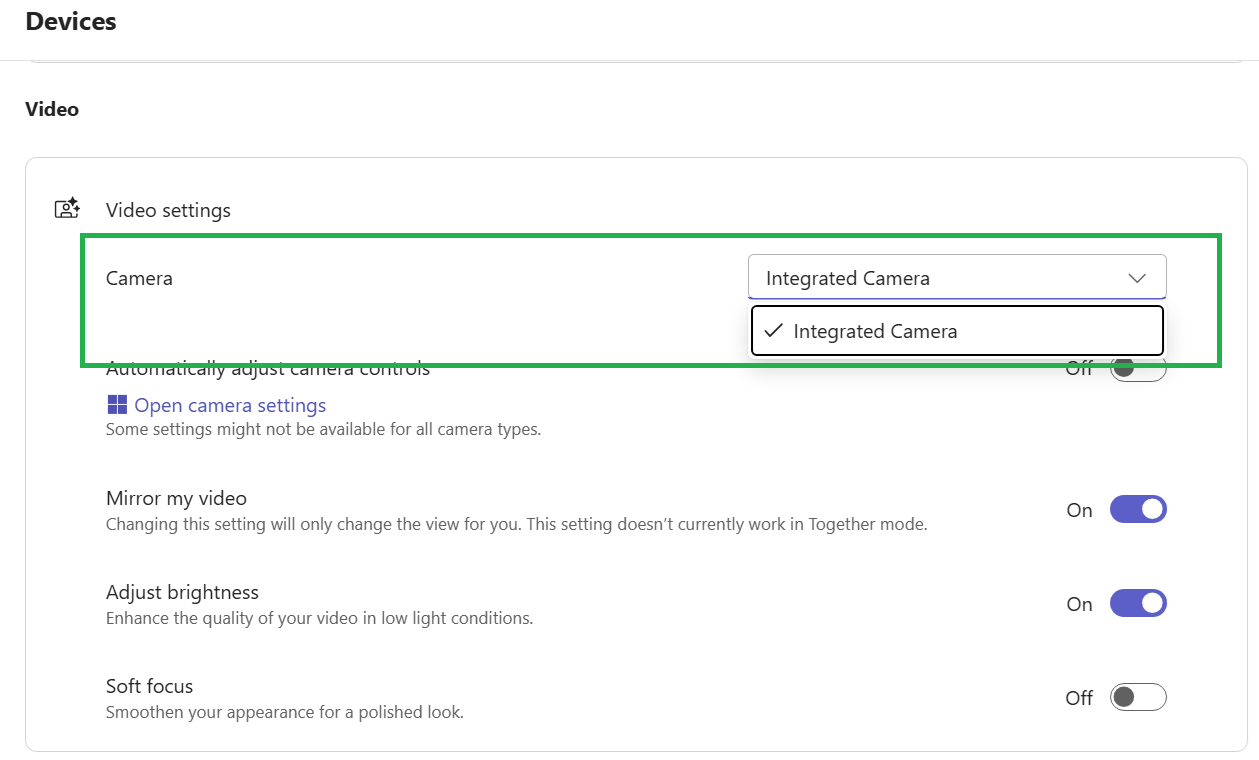

    3. Test the camera in Teams
      • In Teams, select Settings and more (… in the top-right) > Settings > Devices.
      • Under Camera, confirm the correct integrated camera is selected.
      • Under Audio settings, select Make a test call and verify that the camera preview works during the test call.
