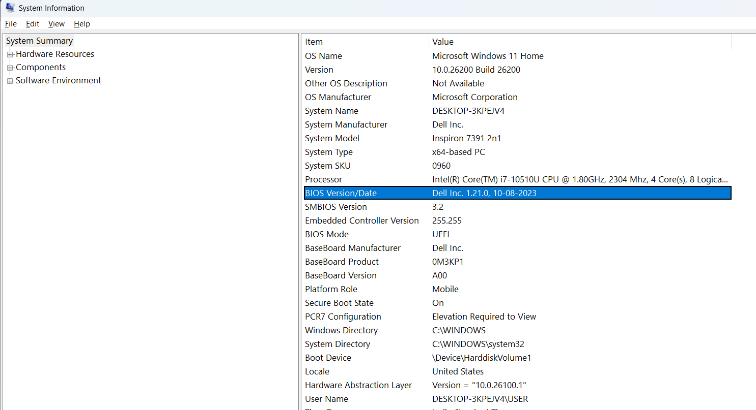

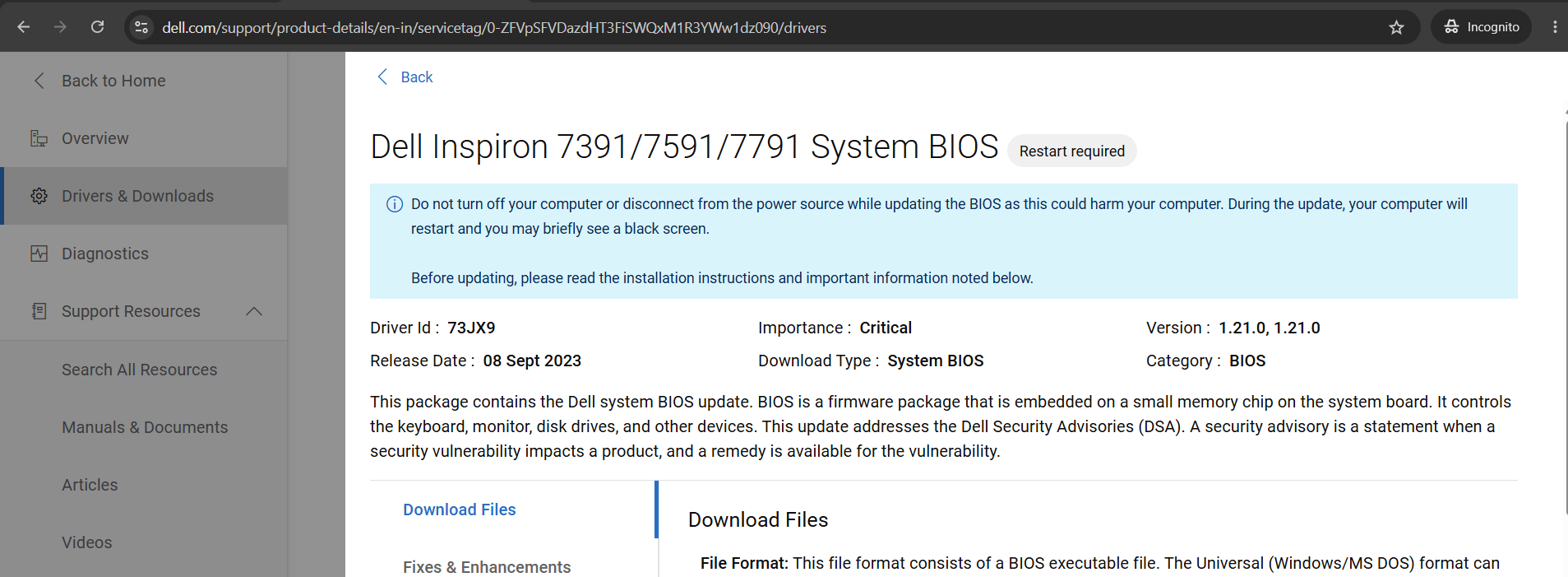

    I have not performed a PC Reset recently. However, last year my SSD was replaced, and Windows was completely reinstalled on the new drive. Since then, I have not performed any additional reset or reinstallation of Windows.
    You must try that now however, your applications will be lost.
    Regarding the BIOS, my current version is 1.21.0 (10-Aug-2023). After checking the Dell Support website for my Inspiron 7391 2-in-1, I found that 1.21.0 is currently the latest BIOS version available, so there are no newer BIOS updates to install.
    Perfect!
